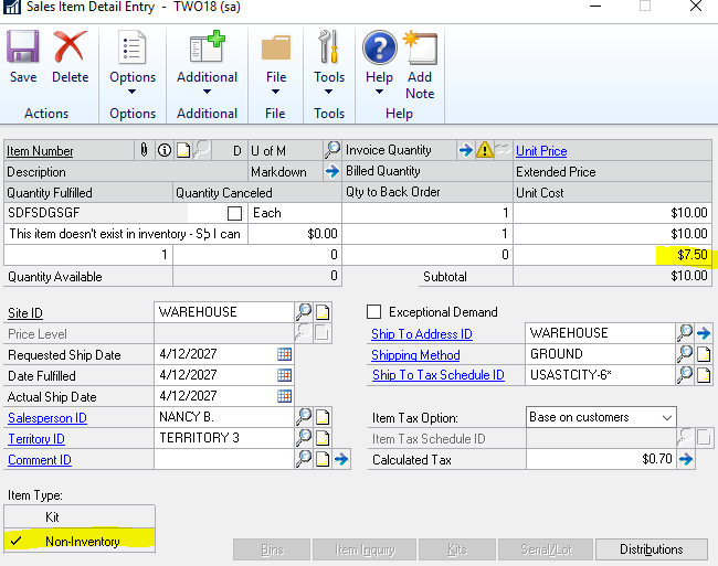

  • 9.  RE: Integrating SOP vs Transferring
    Posted 12 days ago
    Thomas,
    You don't really make a non-inventory item.  It doesn't exist in the item master card.  You just import the item number and description into the SOP line.
    Make sure your SOP setup is set to allow non-inventory.  You can try it manually first.  Go into SOP entry and create an invoice and type gibberish for the item number.  You'll notice it now lets you enter the unit cost.
    Andy Kennedy
    Velosio

  • 12.  RE: Integrating SOP vs Transferring
    Posted 12 days ago
    Thomas,
    Go into your SOP setup Options and make sure it is checked to allow non-inventory items.  Tools >> Setup >> Sales >> Sales Order Processing >> Options.
    Andy Kennedy

  • 13.  RE: Integrating SOP vs Transferring
    Posted 11 days ago
    I checked the option.  Tomorrow I will try a test import to see what it does.  After being off for extended days on the 4th I need to get caught up before I can 'play'. Andy, I appreciate you patient assistance.​​
