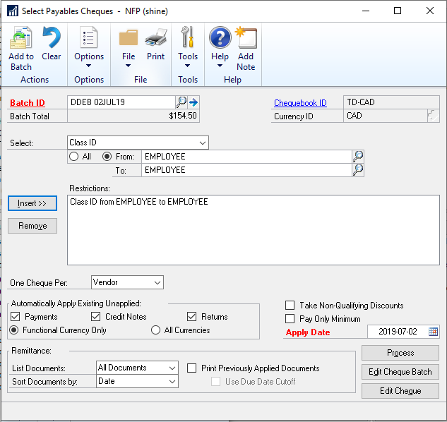

  • 9.  RE: Select Cheques - some Employees not selected
    Posted Jul 02, 2019 03:57 PM
    Hi all,
    Adding some screenshots because this happened again this week:
    As you can see...some of the employees with Class ID = EMPLOYEE were selected. I verified that they all have outstanding balances, on posted documents, dated today or earlier.
    Not sure what to investigate next.

  • 10.  RE: Select Cheques - some Employees not selected
    Posted Jul 03, 2019 08:53 AM
    @Sharon Hine,
    When you are in the ​Edit Payables Cheque batch screen what happens if the user selects one of the EMPLOYEES who do not already have a checkmark beside them? Does that add them to the batch?
