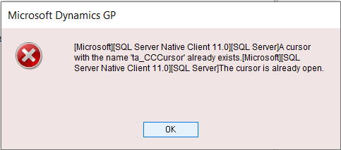

    Hi!
    I am curious if anyone else has had a problem with the PSTL Customer Combiner and Modifier in GP 18.3.   We upgrade on Oct 1st (just a few weeks ago) and this is the first time I've use the Combiner since upgrading.  I've done this over 56 times in GP 2015 R2 (Yes, I have a copy of all of my csv files - I know how they need to be setup :) )
    I have a file with 47 records.  The file validates just fine, but when I process the PSTL Combiner, a "ta_CCCursor SQL cursor already exists" error after about 10-15 records are processed.  I close the errors and it proceeds.  After another at about 10 or so more records the error reappears.
    I thought there might be a problem with the customers at those records, so I moved them to the top of the file, restored my test company, and reprocessed the PSTL file.  It process the problem records (that are now at the beginning of the file)  but gives the same cursor error around the same record number as the first pass.
    So, I created a macro that Enters the customer numbers and process the record one at a time.  I used Replicator to repeat this macro calling the PSTL modifier once for every customer.  Again, it fails with the Cursor Error after about same number of records.
    I recreated the macro, opening the PSTL screen, entering the customer numbers, process the merge and then closing the PSTL window.  Ran Replicator again with my 47 records.  When playing back the macro, the error still appears.  The I rearranged the customers if failed on to the top of the list, restored my Test system (for the 20th or so time) and played the macro again.  It fails again with the same error about the same record number, not on any specific customer.
    Has anyone else had any similar issues with GP 18.3 and PSTL's Customer Merge operation?

    I'd like to thank everyone for their input.
    Here's what I've done and learned...
    I used GP Power Tools (Thanks @David Musgrave) to Script out the SQL that was running.  The stored proc rmCustomerCombiner is called for each customer being modified.  That ends up calling the stored proc rmCustomerCombinerMaster.  rmCustomerCombinerMaster has what I would consider a bug.  It has the following logic
    CREATE CURSOR ta_CCCursor with some SQL code to excute (updates or deletes)
    Open the cursor
    While the cursor is happy, loop
       Execute some SQL returned by the cursor
       if There as an error
           Set an error state and RETURN from the stored proc
    End While
    DEALLOCATE CURSOR
    This pattern is in the rmCustomerCombinerMaster 11 times.  One of my pet peeves in programs is routines that have multiple returns.  Why?  Because it is easy to forget what needs to be cleaned up when returning early.   In this case, the RETURN happened before the DEALLOCATE CURSOR is called.  So, when there is a problem on the 10th customer, the 11th also fails because the cursor was not DEALLOCATE properly on the 10th record.
    So, I restored my test company (again...), updated the rmCustomerCombinerMaster stored proc deallocating the cursor before each return.  Then, I used replicator to create the SQL code to call rmCustomerCombinerMaster for each of my 47 records:
    DECLARE rmCustomerCombiner CHAR(27)
    DECLARE @retstat INT
    DECLARE @param3 INT
    DECLARE @Customer CHAR(31)
    SET NOCOUNT ON
    SET @Customer = 'C05650'
    EXEC @retstat = rmCustomerCombiner @Customer, 'C21290', @param3 OUTPUT
    SELECT @retstat, @param3, @Customer AS '********'
    SET @Customer = 'C14476'
    EXEC @retstat = rmCustomerCombiner @Customer, 'C65323', @param3 OUTPUT
    (Rinse and repeat)
    After running the script in SSMS with text output, I saw what I and everyone else expected...  an ISV problem.
    Violation of PRIMARY KEY constraint 'PKW5026CustItemRevs'. Cannot insert duplicate key in object 'dbo.W5026CustItemRevs'. The duplicate key value is (C50733 , E3-2000-750-NE-H-D-B , 1.00000).
    Sorry for my rambling, but I thought you might want to see the results.  It turns out the customer I thought had the problem didn't, the previous one did.
