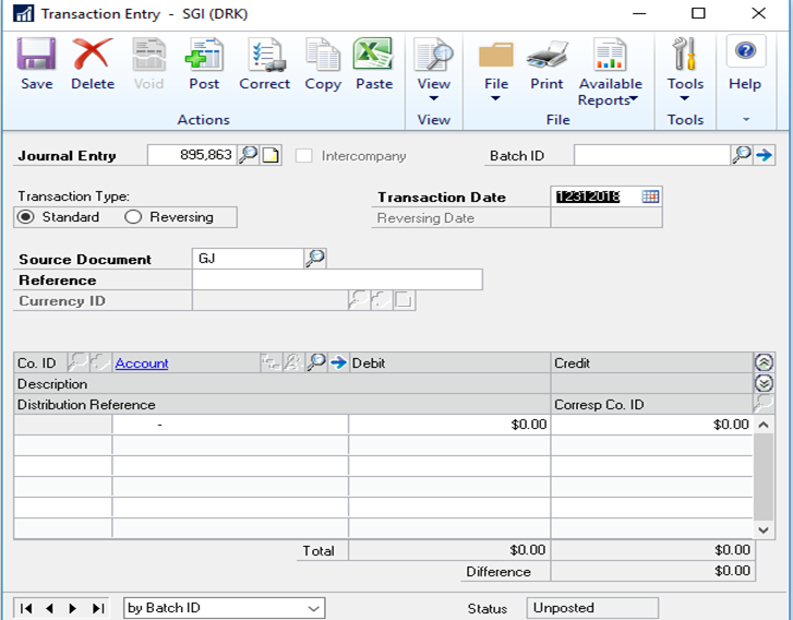

    After a recent year end update the two companies we have set up now come up with different GL Journal Entry screens
    One says Signature Transaction Entry
    One says Transaction Entry
    Doesn't appear to be a big deal but a couple differences I noticed
    The one that says Transaction Entry doesn't seem to allow for "Add Notes"

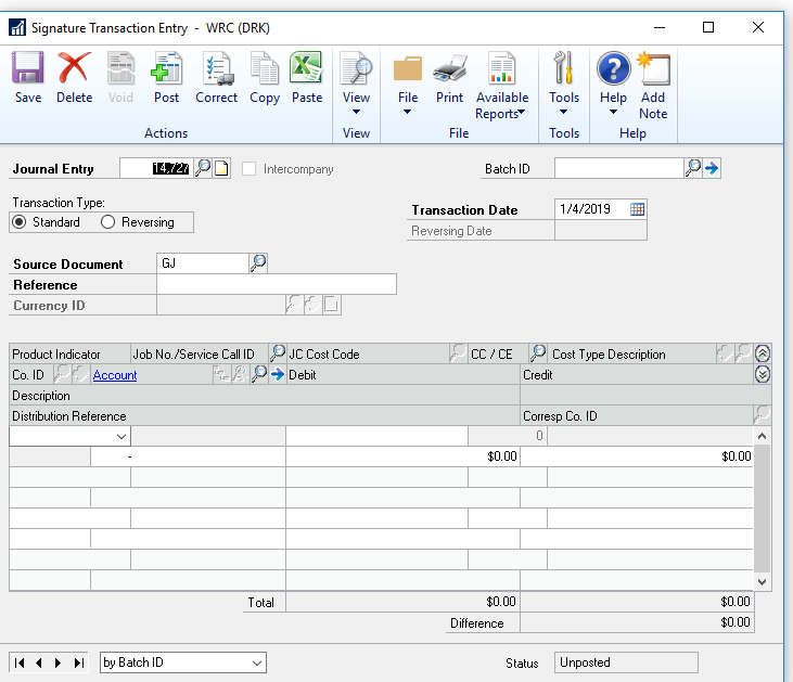

    The signature transaction entry has a drop down box under the Distribution Reference.
    Appreciate any insights

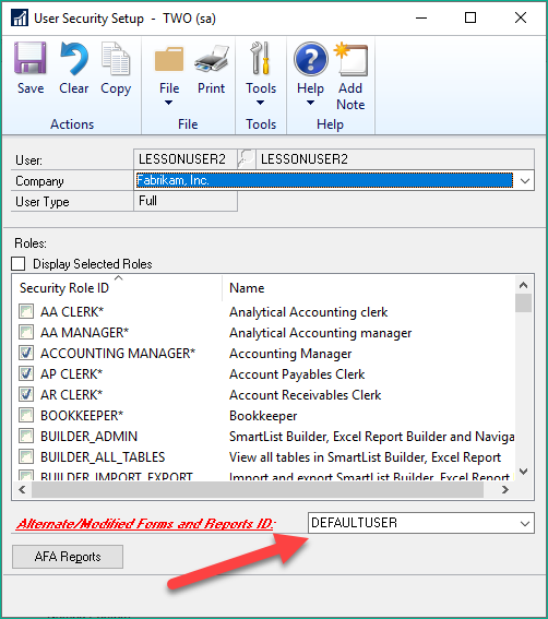

    It is most likely a set up of securities.  In User Security: Administration>Setup>System>User Security check to see if the user (you or someone else) is set up with a different Alternate/Modified Forms and Reports ID.
    If they are, then you can change them to use the same A/MFARID or you can alter the actual setup of the A/M Forms and Reports.
    If you guys are in fact using Key2Act (WennSoft) then you'll need to make sure users are pointing to those modified screens so that you get the Key2Act functionality
    - if you are not using Key2Act in one company vs the other then your setup is probably fine.

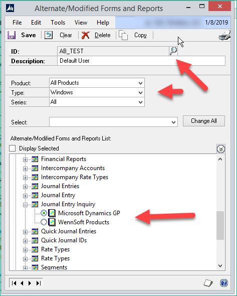

    To modify which windows user see in their Alternate and Modified Forms and Reports ID open that window at Administration>Setup>System>Alternate/Modified Forms and Reports and pull up the ID in question
