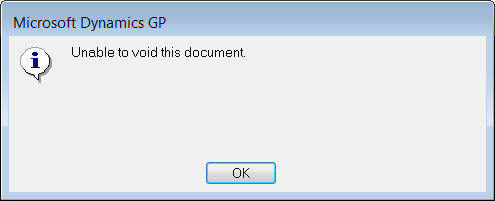

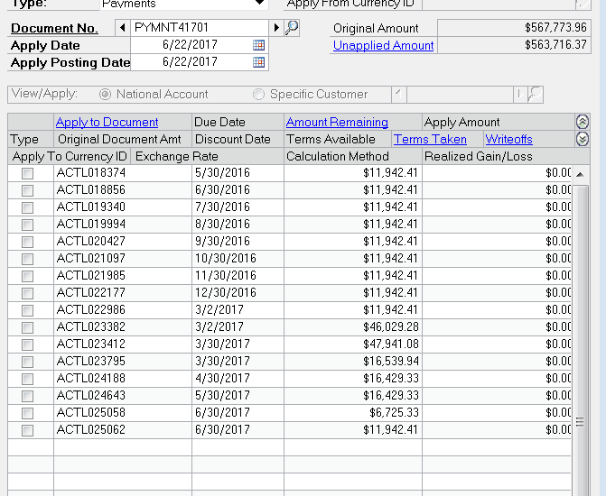

    While applying funds received we ran into an error where when we unapply the full amount of the receipt the unapplied amount doesn't match the original amount. We have played with restarting GP and reapplying amounts, however none of this works. I then attempted to void the original transaction in order to post a duplicate without the error. At this point I received the error "Unable to void this document".
    I then attempted to run check links on the Sales Series, but it was of no use.
    Images are below regarding the failure to void, as well as Original Amount and Unapplied Amount Differential. I assume this means that something is locked in a table and needs to be fixed, but I lack the technical know how to go about this without further assistance.

    Did you try running a sales reconcile (under routines) on the customer id?  Normally that would clear up any discrepancy like this.

    Worked Perfectly!!!!
    Thank you!
    Quick note - it was under Tools > Utilities > Sales > Reconcile
    From there I just selected Outstanding Document Amounts and hit Process.

    You either have a phantom record in your RM apply table or your RM keys current transaction amount is not updating with the checklinks.  You can try to go old-school on this one for a quick fix:
    1.  Enter a dummy credit memo for the amount that shows as the current unapplied and apply to the invoice to get the invoice fully applied.  (Your window showed all of the invoices for the customer - there is probably just one or two where the current transaction amount and the original amount do not match - see if you can locate.)
    2.  Run paid transaction removal just on that customer to get the invoice and dummy credit memo to history.
    3.  Re-enter what needs to be done.
