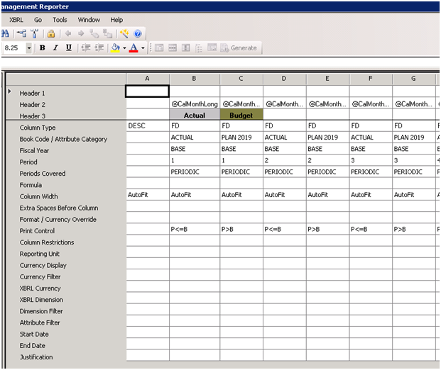

    ​I'm trying to build a 12 month forecast in Management Reporter.  As months are complete, actual will be reflected; otherwise, budget will be reflected.  There will also be a total column showing what the Year-End forecasted amounts will be.
    This is what I have so far:
    Column Definition
    I have this formatting going out to Period 12.
    What I can't figure out is my total column.  How should it be setup?  Ultimately, it should sum what is shown on the report.  If I ran it through March, it should sum the Actuals for Jan-Mar and the Budgets for Apr-Dec.
    I appreciate any help you have to offer.

    Hi, simply do a range column calculation (e.g. B:Y) and it will only add printing columns.  Please see the attached for more details (could not get website attachment to work so email me and I can send).  I love purpose built report writing tools with re-usable and interchangeable rows/columns/trees, oh my!  :)​

    ​Your total column is a calc with the formula = the range of all columns.  For example, B:Y.  Columns with conditional options are not included with any calculations (if the calc uses a range).  So B:Y ignores the unprinted columns in the total, but B+C+D+E... includes the unprinted columns.
    We generate the same report you are asking about and it works great.

    ​Thanks everyone!  I got it to work.  I also figured out one other hang up I had with the report in wanting to have a conditional Header.  I wanted it to say Actual if actuals were reported and Budget if budgets were reported.  The Header would be each word only once spread over each associated month with a box and shaded.  It took a little bit to figure it out and quite a few videos and tutorials.
    I was able to make it work by having the 1st Header go from B to Base and the 2nd Header go from Base+1 to Y.
