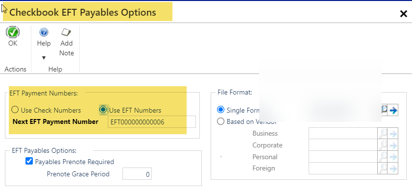

    It is possible to select a range of document numbers as shown here:
    Further EFT payment document numbers will the prefix you defined in the Checkbook EFT Payables Options window
    So it should be easily identifiable to arrive at a block of document numbers.
