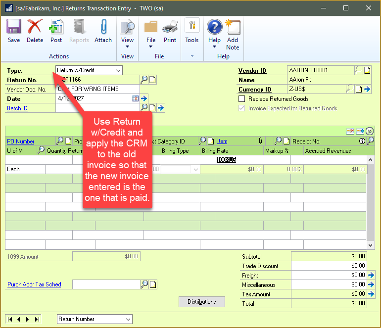

    We received several inventory items and they were received as we normally do through receiving transactions as a shipment invoice type in a purchasing batch with no purchase order attached, only the inventory items.  However, when such inventory items were received, the items were mixed up and enter as the wrong items and quantity.  My inventory cost for each item is now wrong because the unit cost and quantity received does not match the corresponding item received.  Is there a way i can reverse this and is so, how do I go about doing this?

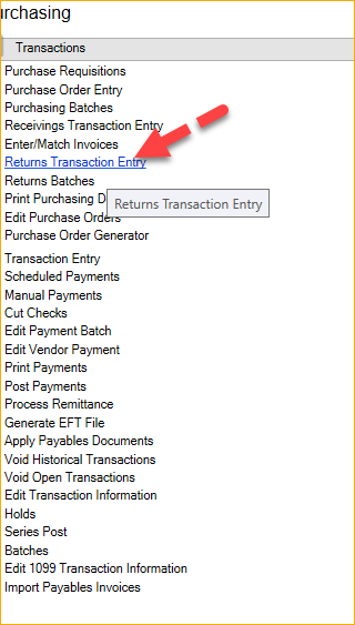

    Yes, you will need to do a ​Purchase "Return" and return all of the wrong Items and then re-enter the Shipment/Invoice.
    Yes, this is painful, but this is the only way to correct the items 'the right way'.  HOWEVER there may be other ways using an inventory transaction but I DO NOT RECOMMEND that because it can affect future reporting on what was purchased, etc.
