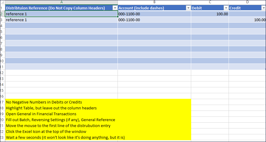

    If you are on GP 2013R2 and over you can copy and past into the GP General screen directly from Excel as @Leslie Vail mentions.   This copy and paste feature is 100% the easiest method for bringing JE's in from Excel in GP now.  Yes you can still use Integration Manager and or SmartConnect, but if it's in Excel copy and paste is easiest.
    Simply open your General Transaction, enter the header information and then place your cursor in the first line of the entry.  Copy the information in Excel, pop back over to GP and use the Excel Paste button in the command area of the entry screen.
    The entry DOES have to be in a specific format by column:
    I have uploaded this document in Excel if you guys would like it below:​​

    ​If you are looking for general ledger journals specifically, then I would definitely go with the standard copy paste functionality of Dynamics GP, it may even cover analytical accounting entries when using AA Alias.

    ​We have GP 2015 R2 and I've found that the Paste function doesn't always work well when you have alpha characters in your account codes.  It may paste all the information, but the debits/credits don't add correctly.
