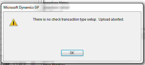

    ​​Hi,
    I am trying to setup safepay for a new company that was created. When I try and upload the checks I get the following error message. I cannot find where I need to define this.

    The  transaction code is not set up in the bank format in the safe pay configurator.
    Tools > Financial > Safe Pay > Configurator.
    Here is a link to help you configure Safe pay.
    Safe pay configuration

    Once you are in the entry for the "Action" type, click on the menu item "Codes Entry", then on "Transaction Codes Entry":
    In our case, we have the code "I" (capital i) for Issue and "V" for Void:
    I hope this helps.

    ​Thank you! This helped a lot.
