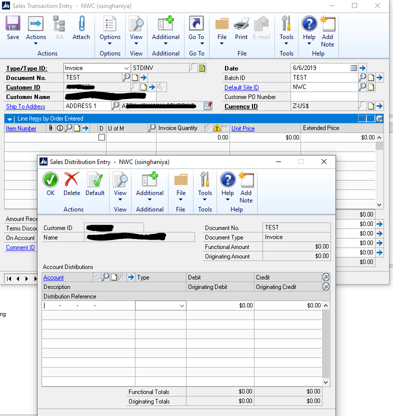

    1. Is there any way to pull Sales Invoice's Account Distribution / Distribution Reference through smartlist?
    I created a batch in Sales > Transactions and before posting the entire batch, I want to check if all of the invoices in the batch has right account distribution (GL code). I would like to do it Smartlist, instead of going to each invoice individually and checking its distribution.

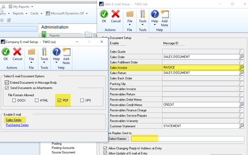

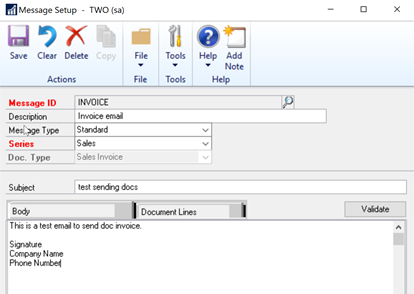

    For the emailing setups, start with the E-Mail Settings and E-Mail Message Setup screens under Administration > Setup > Company. In these screens, you determine which documents you want to enable emailing, create your standard email message and assign your message ID to the right document type.

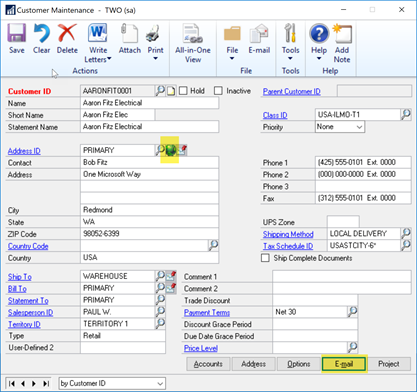

    Next, you need to be sure your customers are setup for emailing. In the customer card, click on the Email button to assign which documents you can email to each customer. There is a way to do this step en masse. You also need to be sure the customer's email address is added to their Customer Maintenance screen (The globe button on the Address ID line for their Bill To Address).

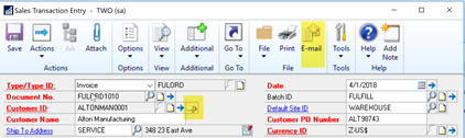

    With the emailing setup in place, when you select the customer in the Sales Transaction Entry screen you will see the email buttons become active. If you click on the email button on the Customer ID line, you can see the customer's email address and your standard emailing message. You can edit the email message for the invoice is you need to. Click on the email button on the ribbon to send the invoice. Use your Sales Batches screen or your Navigation Lists to email multiple transactions at one time.
