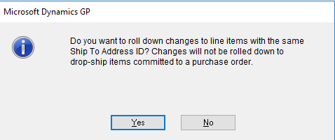

    Is there anyone who has had the issue of GP 2015, not printing the correct ship to address on the order sheet and packing slip? The correct address is on the picking slip, just not the others. I have created an SQL script to roll down the ship to header to the line items. Yes it is a fix, but I would like to know the reason why it did this in the first place.

    It's possible that it's due to a ship to address change at the header level after the lines have already been entered.  If you do change the header after lines exist, GP will ask if you want to roll the change down to the lines.  If you say No, then you'll see what you're seeing.

    ​We've had that same issue before too. It happened when the header address changed after line items had been entered but the user did not click to roll down the changes to all line items. Besides running a script, if you don't have a lot of line items, you can also change it directly from the line item. You can also update shipping methods this way.

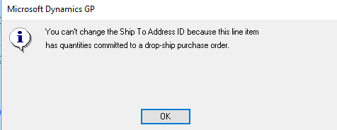

    Anyone know how to update an address on a SOP line item that's drop ship from a vendor?  We don't always have the ship to address immediately but want to get the vendor PO off asap so that part of the order isn't delayed.  When we have the ship to address, we enter it at the header, roll it down to the lines, but you can't roll an address down to drop ship lines.  We have AvaTax calculating sales tax so not having addresses causes issues for our customer service team.

    At issue is the Commitments you have turned on in Purchase Orders, once a line item is listed as committed, it really can't be changed.
    Let me ask you on the drop-ships PO's how are you updating the vendor to what customer address to ship these to after you do know the address?  If we can figure that out we might be able to assist with more targeted suggestions on how to do this where you don't encounter this error.
    That or you can turn off commitments by unchecking THIS box when entering these particular types of Drop-Ship POs:

    Not using the commitment (unchecking it) did not seem to affect my ability to receive/invoice from the vendor nor transfer the SOP document to invoice.​
    Commitments are usually about other than the SOP to POP link, so do check within your organization to find out why the Commitments are turned on.  If there seems to be no reason why then I would recommend creating or updating your Test Company and turning OFF PO Commitments and running through a few tests of not only the Drop Ship PO's but other types of PO's as well.
    If it all works correctly in the Test Company, then you can turn them off in Live.
    Commitments are usually used for budgeting and other ​Purchasing authorizations and have, really, nothing to do with Sales or how the POP system works.
    BUT, before doing anything check organization-wide to see why they were turned on in the first place before turning them off.
