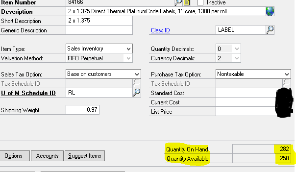

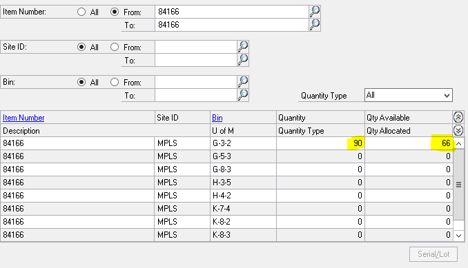

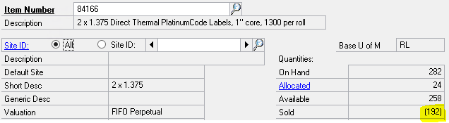

    We are having an issue where our Qty on hand varies from the bin quantities and there shows a negative quantity sold. This is because we posted some returns through that apparently had not fulfilled the items fully, causing our quantities to get out of wack. Any suggestions on how we could resolve this would be much appreciated!
    Item Card:
    Item Inquiry:
    Bin Quantities:

    Two things that come to my mind:
    1. This usually happens when an RMA is posted without selecting the proper return Qty Type in the screen to put the returned quantity back into inventory On-Hand.. something that is easily missed most of the time
    2. Run an inventory reconcile (you can limit it just to this item), and if the QTY on hand isn't still correct (which it will probably not), you'll have to create a manual adjustment (either thru a cycle count or an inventory adjustment transaction)​
