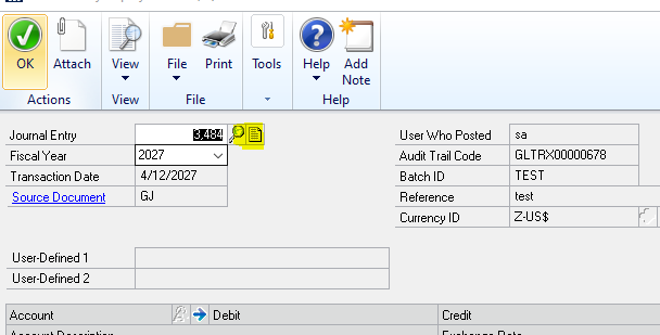

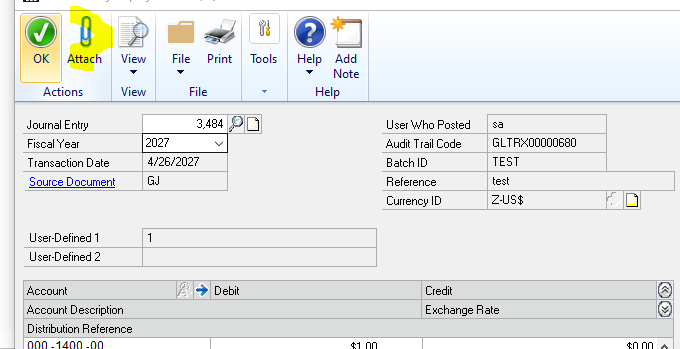

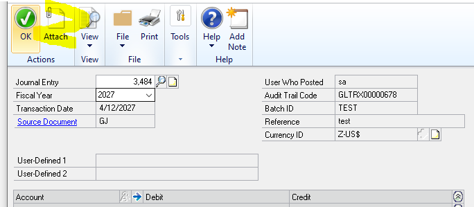

    Can you please confirm which version of GP you are using?  I am testing on 18.3.1245, and I have a recurring journal entry batch (weekly) where I have some that have the document attached (if I attached it to that individual week's posting) and some where I elected not to attach anything.
    Please note that I am using the "new" Document Attach that shows itself as the large paperclip icon in the navigation ribbon along the top.

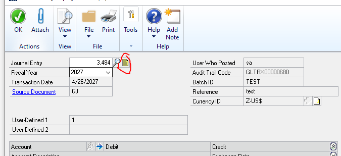

    I can replicate what you seem to be indicating IF I use the "old" document attach method of clicking on the note icon next to the journal entry number ( affectionately refer to it as the post it note) and attaching the document through that method.
