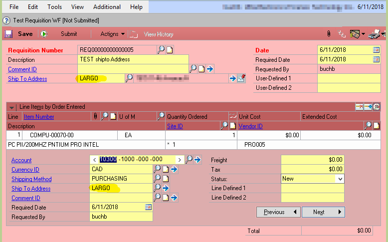

    Unfortunately not much has changed in 2018 in this regards.. However, if you setup the Purchase Réquisitions for your users, at least you get them a chance to chose a different ShipTo Address, whereas in the default PO Entry form, it defaults to the PRIMARY address that is setup in your company setup screen..
    By using the Requisition entry form instead of PO Entry form, your users are forced to submit for approval the purchase and it can be corrected if not right, and the Ship To field is empty by default, which gives them the ability to select one from the pull-down list (looked up from your company's address list setup).
    If they do not select a default Ship To address, then the approver can return the requisition for  correction.
    I don't really see another way of handling this, unless you don't want to go the requisition route and enter the PO's directly, then your only other option as mentioned in my prior reply, would be to use a hard-coded Ship-To address on the POP Blank report in a customized version.
