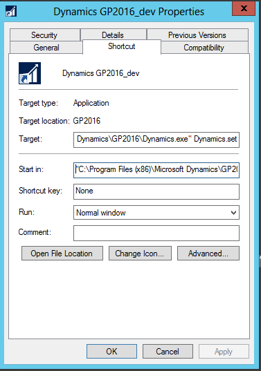

    I've never modified a form in GP, but would like to make a simple change to our Purchase Requisition Screen that would greatly help our end users.  My concern is corrupting the forms dictionaries that are currently being used.
    From what i've read I should create a separate shortcut for GP and have the target in the properties menu point at a different Set file.
    Does the "Start in" location need to change?
    Within the set file, what .dic files do i need to recreate and point to a different location to prevent changing things that other users are using?
    I am working on a terminal server with the reports and forms dictionaries being located in a shared location.
    dynamics launch

    Actually, what you need to do is create a separate dictionary and .SET file for testing.  It's pretty easy to do: simply find your FORMS.dic file (or REPORTS.dic file) and make a copy, renaming it to something you want to use long-term.  Then create a copy of the dynamics.set file and rename it.
    Now, what you have to do is repoint the modified .SET file to point to the modified Forms/Reports dictionary.  The .SET file is separated into two parts: the top contains a list of all the modules and third party applications and the bottom are the directories to the dictionaries used by those modules.  Simply adjust the path to point to the modified Forms/Reports dictionary - the copy you just made.  You should be looking for a section which looks like this:
    Windows
    :C:Program Files (x86)/Microsoft Dynamics/GP2018/Dynamics.dic
    :C:Program Files (x86)/Microsoft Dynamics/GP2018/Data/FORMS.DIC
    :C:Program Files (x86)/Microsoft Dynamics/GP2018/Data/REPORTS.DIC
    Take care to match the path syntax, using forward slashes instead of backslashes.  I use modified reports on all my companies so that section of my .SET file looks like this (note that we use a shared drive for shared report dictionaries, making maintenance and admin easier):
    Windows
    :R:GP2018/OCI/REPORTS.DIC
    Lastly, you'll need a shortcut that launches Dynamics and points to the modified .SET file.  To do this, make a copy of your Dynamics shortcut and modify the path (right-click on the icon and choose "Properties").  All you have to do is add the name of your modified .SET file to the end of the "Target" section (see example below).
    "C:\Program Files (x86)\Microsoft Dynamics\GP2018\Dynamics.exe" "OCI.SET"
    This assumes that the .SET file you created lives in the same directory as the Dynamics.exe file (on a common install these are in their own directory located at  C:\Program Files (x86)\Microsoft Dynamics\GP2018.
    If you set it up this way, you can make all your changes to your "modified" Forms/Reports dictionaries (which at this point noone but you will be using).  Once you are ready to go, all you have to do is copy the new .SET file and shortcut to the new user's computer and have them launch Dynamics using the new shortcut.  (This assumes that the new dictionaries are in a shared location.  If you put them on the user's PC, you'll need to copy that locally as well.)
