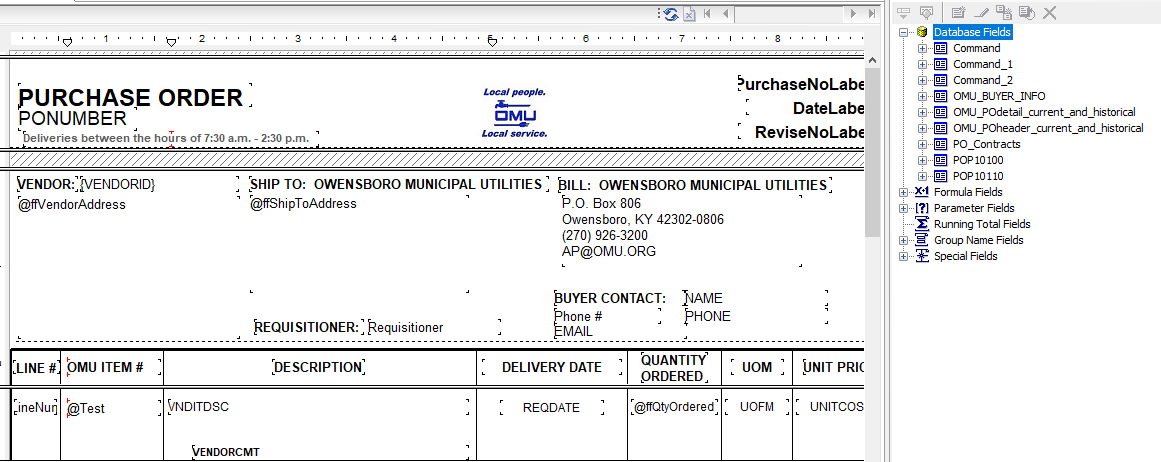

    It's no problem at all if you are familiar with Crystal Reports.  You can link any GP table or view to the existing stored procedures to get the fields that you need.  As you can see, we have added quite a few tables and views to heavily modify our purchase order...

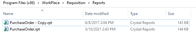

    We renamed the original Purchase Order in the Workplace\Requisitions\Reports to have as a backup.  We then copied our modified crystal report into that directory.  I didn't want to modify the existing stored procedures since those will probably be modified at some point if you upgrade Workplace.

    One other thing, and then I'll leave you alone...Can you provide a screenshot of the Database Expert in the report? I want to try to mirror what you're doing as closely as possible.
    Greg, I really appreciate your help with this. Thanks very much.
