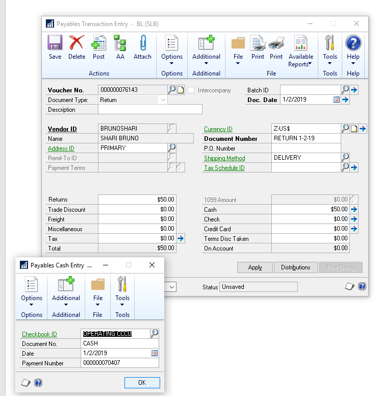

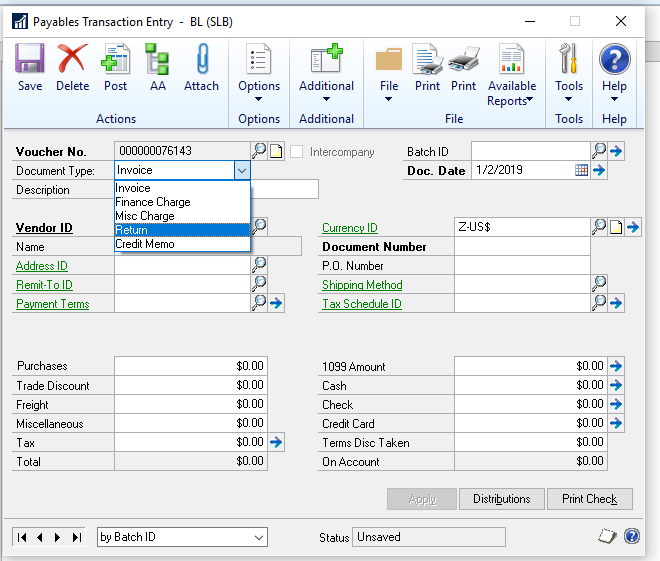

    ​Hi @Lauren Leon
    You can also process a Return that will allow you to credit whatever account is needed, and create a Bank Deposit Entry​​:
    I like this approach because it leaves an entry in the vendor record as a Return which helps us separate actual credit memos from checks/cash received.

    ​Hi @Lauren Leon
    When entering a Return, input the amount into Returns field on the left, then on the right side input the amount into the Cash or Check field. Both fields will open a new window that then allows you to choose the Checkbook ID for the checking account where the deposit will be made, as well as assigning a unique Document No. It is important that the Date on the Payables Cash/Check Entry window be the same as the system date for GP.
    The Payables Transaction Entry Distribution window will have a Credit line for PURCH where you can enter the GL that you want credited, and will default a CASH debit for the checking account that will receive the deposit.
    After posting a Bank Deposit Entry will be created and you will process the deposit as usual.

    ​Hi @Lauren Leon
    Your question makes sense. You're correct, the Return is recording the GL portion of the bank deposit but not the deposit itself. When you post the Bank Deposit Entry that was created by the Return the deposit will be recorded to the checkbook, which is then reconciled to the bank statement. There is no other offset to that because the transaction ends as a DR to cash.
    As to the debit to the expense account, that happened when you originally processed the invoice. The credit of the return is lowering the total expense the same as it would if a credit memo was applied.
