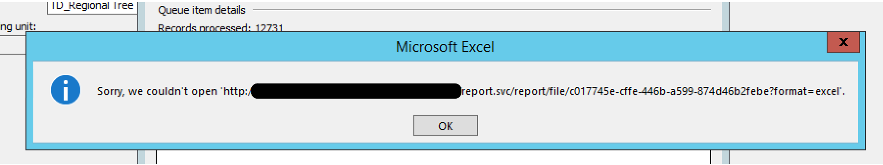

    We are having an issue where we cannot seem to export to Excel from Web Viewer. We can do it from Report Viewer though. The message I'm seeing when the file tries to open in Excel are:
    Sorry, we couldn't open 'http//XXXXXXXXX'.

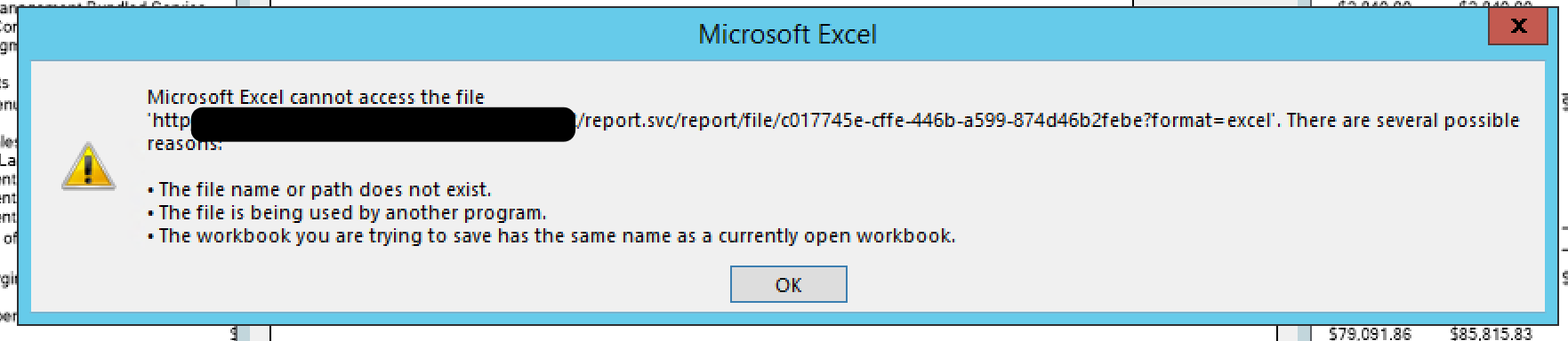

    Then I get
    Microsoft Excel cannot access the file http://xxxxxxx for several possible reasons:
    -The file name or path does not exist
    -The file is being used by another program
    -The workbook you are trying to save has the same name as a currently open workbook

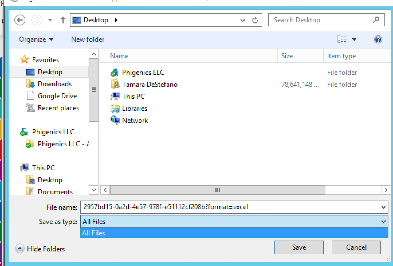

    When I select Open from the Open/Save/Save As window, I get these two messages:

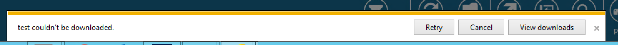

    When I select Save or Save As from the Open/Save/Save As window, I get these messages:
    If forces me to change the file name. In this I changed it to "test". Then I get:
    We run on a terminal server and all users are having the issue. It seems like there is a setup issue, but I can't seem to figure out what is missing.
