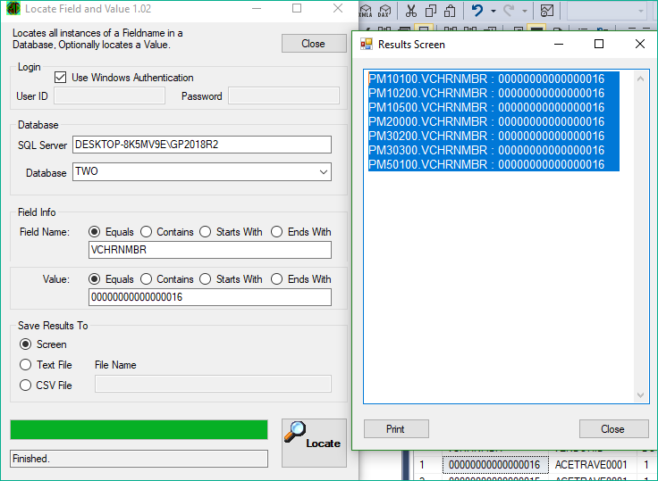

    I have attached a tool I use to find transaction when I need to repair them.  Here are screenshots.  I did research on one transaction in my test company it it was in these tables - and I've named a few of the tables for you here.
    --PM10100.VCHRNMBR PM Distribution Table for Work and Open
    --PM10200.VCHRNMBR PM Apply to for Work and Open
    --PM10500.VCHRNMBR PM Tax Table​
    *CAUTION:  Data Repair in GP can be tricky so if you are not used to it or are not 100% comfortable, please reach out to a partner for assistance.*

    Interesting, @Jo deRuiter. I use a SQL-only version of this app; so it has to be used w/SSMS or with the GPPT SQL statement executer.
    Where did this app come from?​

    Hi @Steve Erbach
    I can no longer remember where I got it, but I can't live without it now, LOL​

    @Jo deRuiter,
    I've become accustomed to using the stored proc that returns the same results:
    EXECUTE dbo.uspSearchAllTablesForAnything
        @ValuePatternToSearchFor = N'%181137';
    This is a sample of the output:
    The main advantage of the stored proc is that I can supply additional parameters:
    Value to search for; can be alpha, numeric, timestamp, or GUID.
    Column name pattern;
    Table name pattern;
    Search In XML fields: 0 = No (default); 1 = Yes
    Show Full Row Results: 0 = No (default); 1 = Yes
    Number Of Rows To Show: Max number of full rows to display
    Anyway, I was intrigued by the app. It appears to produce results faster than the stored procedure.
