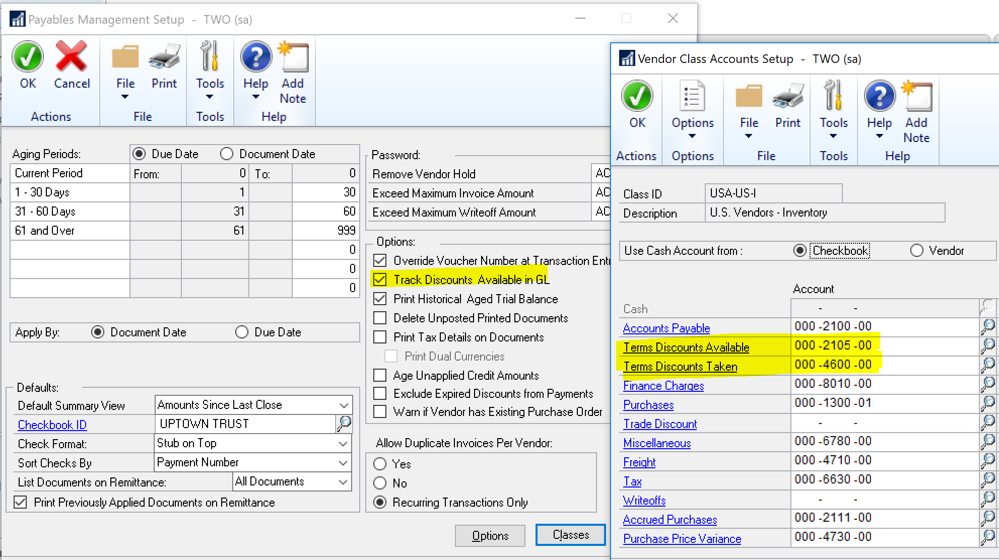

    If this is something you really need to track, you should look into turning on the Track Discounts Available option in the Payables Setup window.
    When invoices are entered with payment terms, it will track the discount available in a separate account.  You'll need to remember that when reconciling AP to GL because you'll need to look at both the AP and discount available accts to tie to the aging report.
    Also make sure to populate the Terms Discount Available and Terms Discount Taken accounts at the vendor or posting account setup levels.
    Beyond that, creating a SmartList to pull this would be tricky because you'd need to do it based on the distributions to figure out if a discount was taken and then reverse engineer into discounts not taken.
