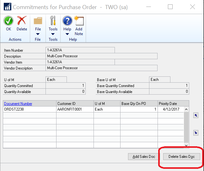

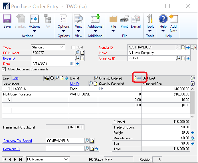

    I would start by 'breaking the link' between the SO and the PO.  At the least, you will be able to invoice the sale.  To fix the receipt, I would start looking for remnants of the transaction in the database.  If there are none, I would do the transaction(s) again.
    To break the link:
    break1
    break2
    I hope this helps.
