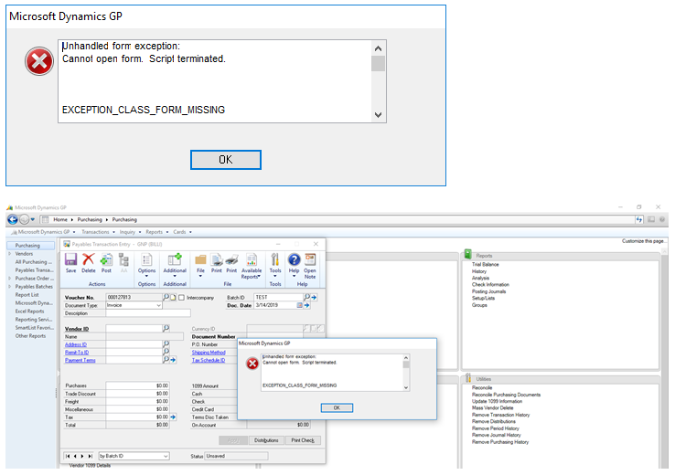

    We have 1 computer that any user that tries to save a payable batch on gets the following error message. The really strange thing is that this also follows that particular user to any other computer that we have.  I am at a loss.  We have Uninstalled and Re-Installed GP on this computer and get the same results. I have tried to Copy the access and security from a user id that is working fine, and this user still gets this message any time she tries to login to a different computer.  We are running Dynamics GP 2013 R2 on a Windows 10 operating system.
    Anybody have any ideas?
    Exception Error

    I susepect that the code is trying to open a modified form and that the install is not pointing to your modified form dictionary. Compare the Dynamics.set launch files from a workstation that works to the one that doesn't work.
    If you still have issues, installing GP Power Tool with its free 30 day trial period will allow you to use the Security Profiler to identify the problem.
    GPPT Portal: http://WinthropDC.com/GPPT
