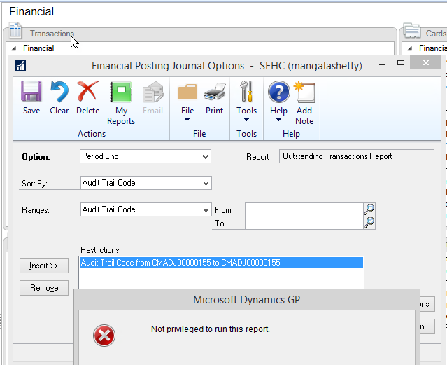

    Happy New Year to all. I need a help with regards to Security task setup to view / print the Report from Financial-->Reports-->Bank Posting Journals.
    We cleaned up the roles and tasks in December and the Accounting is not able to view or print reports. They get an error "Not privileged to run this report".
    I tried creating a test role and adding all the below tasks and it did not work. When I login as DYNSA - I can run this report without any issues.

    Please help to identify which task is required to print this report.

    I created a Test Role adding the below tasks as you suggested, unfortunately doesn't work for me. DYNSA login works, but when I login as a user, it gives me the same error.
    Security roles that I assigned to the user:
    The tasks are added under the role 'TEST' as below;
    Please advise if I need to run CheckLinks or need to add additional tasks. Sorry for the bother.

    I checked the sub-tasks under the Tasks as you said. But I get the same error "Not privileged to run this report".
    Please see screen-prints below;  I can print other reports from the list eg., Bank Transaction Journal. Just the Outstanding Transaction Report is not printing.
