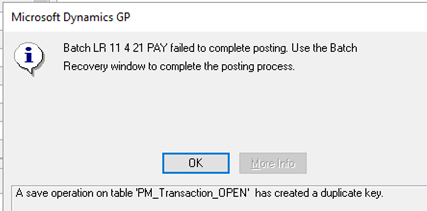

  • 1.  Help with Batch whose Status is 'Posting Interrupted' please "A save operation on table 'PM_Transaction_OPEN' has created a duplicate key.
    Posted 26 days ago
    I"m in a bad maze and feel there is a tiny way out, but I can't find it. Batch recovery continually states 'Process Interrupted'.
    Initial error window:
    Batch recovery does nothing. I have researched and even tried running Checklinks, which found no errors. In the SY00500 table, I flipped BCHSTTUS to 0, was set to 7 in my initial investigation. Upon flipping to 0 and trying to reprocess it sets back to 7. Tried the processes again, nothing.

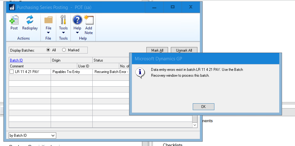

    I was able to open up the batch somehow and the edit list shows the below. Can anyone shed light on the below messages? The user cannot edit the transactions as it states to use the batch recovery, but that is a bad loop I get into.
    they show up in Financials > PMTRX
    SQL data
    Select * from DYNAMICS..SY00800 - No data
    Select * from DYNAMICS..SY00801 - No data
    Select * from TEMPDB..DEX_LOCK - No data
    Select * from TEMPDB..DEX_SESSION - No DEX row for this data/batch
    Please help me get out of this bad loop.
