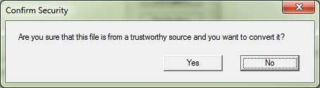

    I just tested sending out one Customer Statement using Adobe Acrobat 2017.  I have this customer set to email the statement and save a copy to a Tab-Delimited file.  This warning popped up twice:
    We email over 150 statements at month end.  I'm guessing this warning will pop up on every one?

    I tried the registry fix in the link you posted.  The warning did not pop up but GP locked after sending one statement.  Here's my setup:
    GP 2013 local
    Adobe Acrobat 2017
    Sending statements using Exchange.
