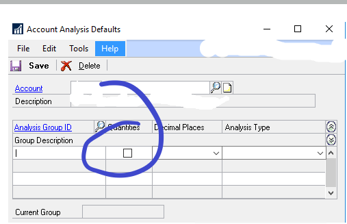

    So it looks like eOne was right and the store procedure was indeed custom (taUpdateMDA_SC).  I had to reconnect with a colleague elsewhere and he confirmed that he did not have that SP @ his organization either.  So clearly, the partner came up with it, and they had to dig the SP up as well, since they had lost track of it.  Once they found it, we ran the SP on the pertinent companies but there were tweaks involved still.  So after several modifications in the SP and the Smartconnect map, we were able to get the JE with MDA map running but another requirement was necessary:
    the qty box needed to be checked on the Account Analysis Defaults window.  (quick update on DTA00300 table/ DTA_Quantities columns).
    Once this was taken care of, the map ran properly.
