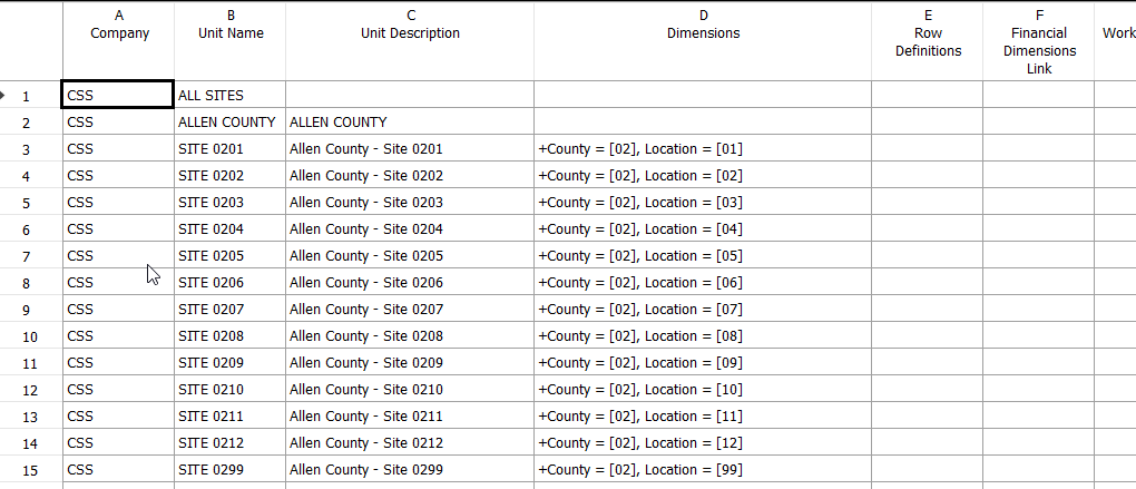

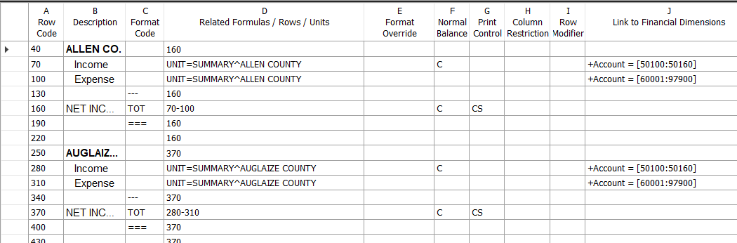

    We have approximately 400 dept(county)/location combinations in our organization. I would like to create a report that will pull the Income, Expense then display Net Income for each of them then have them all on one page split by dept. I am able to use our location tree with the row definition below to get one dept(county)/location combination per page. Is there a code that I can use on the row definition that tells it to repeat what I have in rows 10-190 to get them all on one page OR do I have to copy/paste rows 10-190 98 more times?
    I have the same setup for a dept(county) report but it only has 17 that I had to copy. LOL  I know that I could do it the hard way and add the same 7 lines for all 400 of them BUT I was trying to find an easier way. 8-)
    This is the Row Definition:
    This is the tree:
    Thanks!!

    This is a screenshot of the row definition for the dept(county) one that I mentioned​ that does work. I did it the hard way and added a line for each unit(county), which is only 17. So, I didn't need to use the @UnitName option. This is the first time that I'm trying the @UnitName option. Since I now need 400 of them I am trying various options. 8-)

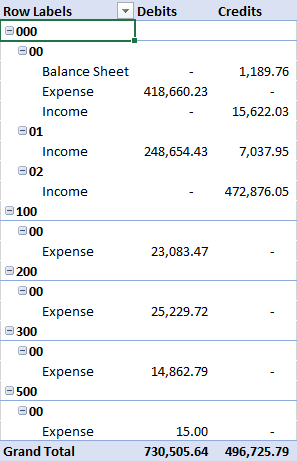

    I was thinking of a PowerPivot, actually. I did a sample with the TWO database since that has a multi-part account number:
    SELECT p.[TRX Date]
    , p.[Account Number]
    , p.[Account Description]
    , p.[Debit Amount]
    , p.[Credit Amount]
    , p.[Account Category Number]
    , p.Segment1 AS Division
    , p.Segment2 AS Account
    , p.Segment3 AS Department
    , p.[Posting Type]
    , p.[Typical Balance]
    FROM [dbo].[AccountTransactions] AS p
    WHERE p.Segment2 BETWEEN '4000' AND '8999'
    AND p.[Open Year] = 2017
    AND p.[Document Status] = 'Open';
    That's the SQL statement in Power Query.
    Add that result to the Data Model and add a Column:
    =IF(tblPandLTrx[Account]<"4730","Income",IF(AND(tblPandLTrx[Account]>"4729",tblPandLTrx[Account]<"5000"),"Balance Sheet","Expense"))
    ... name the column IncomeExpense. Then make the Pivot.
    In the Pivot,
    The Pivot looks like this collapsed to the highest level:
    Then we open up the top level:
    ...and open up further:
    ... and we're starting to look like what you want. The 100/200/300 level is your County; the 00/01/02 level is your Location.
    Does this help?

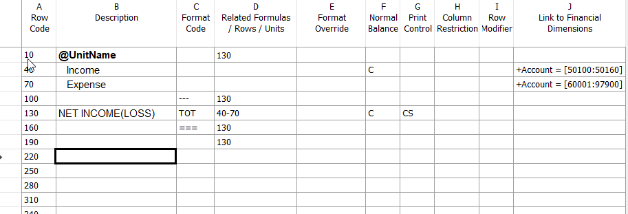

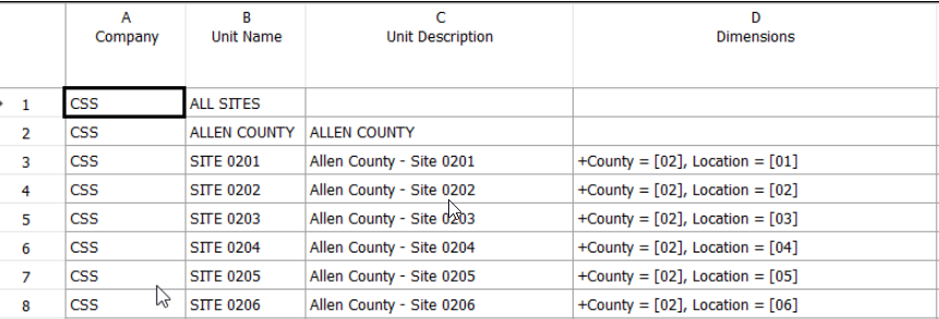

    I was trying to avoid building a row definition with Revenue, Expense and Net Income for all 400 of our locations​.
    EUREKA! I have a break through! I was still able to use @UnitName in the Description of the Row Definition to pull all of the locations from an existing tree then export to Excel to get them all on one report. There is just a minor glitch. 8->
    Here's how I finished it. I took @Annette Brown's advice (thanks Annette) and removed extra lines from the Row Definition then unchecked the "Include headers and footers" box in the Report Definition before I ran the report then again when I downloaded to Excel from the Report Viewer. They are now appearing on one page. However, it still includes the column headers (Current JAN, Current FEB, etc), which looks really redundant. Does anyone know how to stop them from exporting other than removing them from the Column Definition all together?
    I'm excited that I got it this far. LOL
    This is the row definition:
    This is part of my tree:
