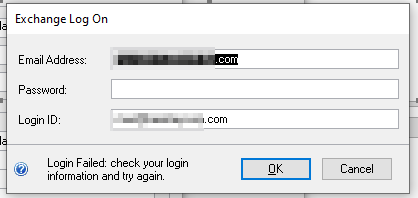

    Hello,
    Our users recently started experiencing an issue with Exchange Log On. Usually they're prompted to login to Exchange when they need to use the email function or update record with email for the first time after logging in to Great Plains in the morning.  And it's worked fine for years. Recently, however, when they get prompted to login to Exchange, they get "Login Failed: check your login information and try again"  as if they didn't type in correct information. We are 100% sure the email, password, and Login ID are correct. The user is not locked in AD or GP. We did not make any recent changes in any email settings in GP. There's no reason why they can't login. They are unable to send emails from GP, which is a big productivity issue.
    We're on GP 2018 with Office 365.
    Please help.​
