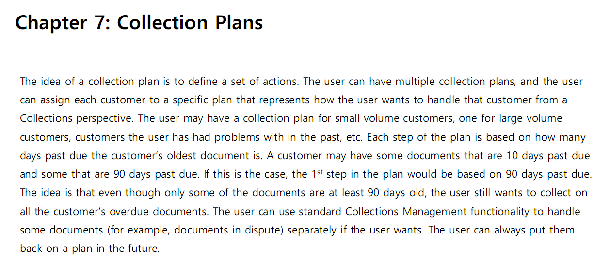

    That really depends on how you work with the CM product in GP..
    If you open the CM user guide, chapter 7 will tell you more about the Collection Plans:
    If you want to use this and notification is failing at login, then you might consider this to be a bug and check for an updated product version.. I just had to check for another client last week and the latest CM build is b481 which you can download from the ProfAd site.
