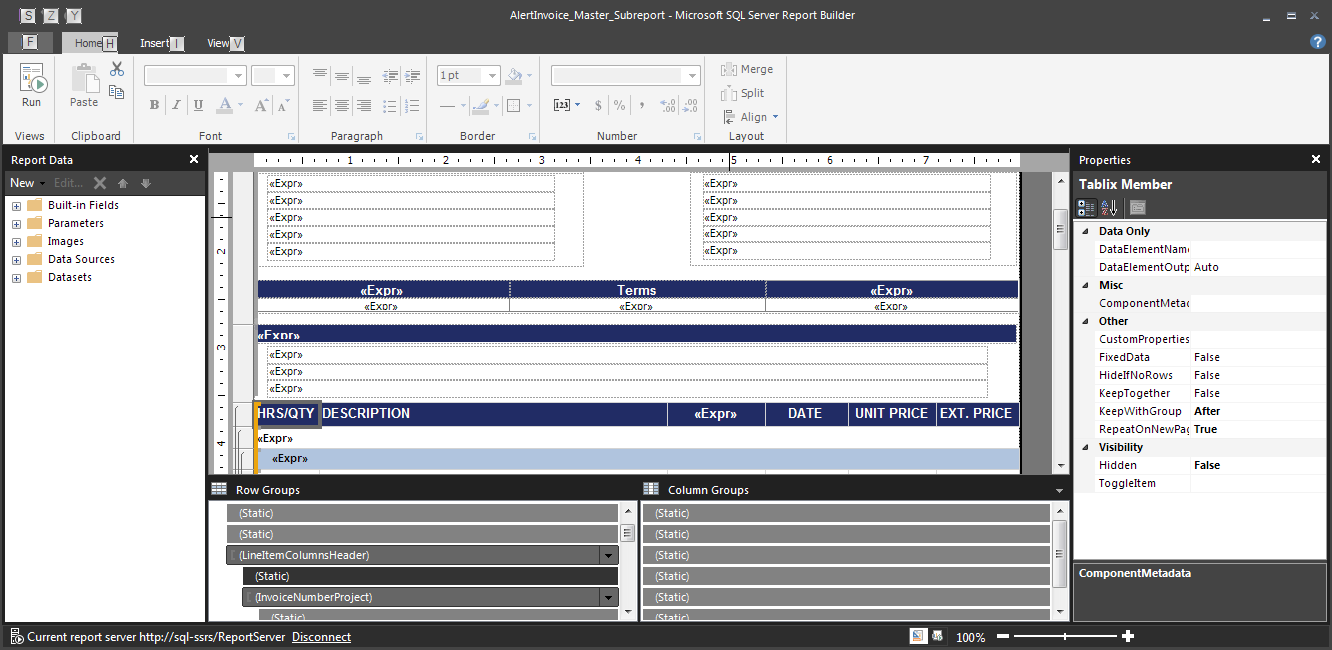

    @Mary Mallazzo ​ you are so close! I promise. Static under column group should all be set to false. It is the Static under ROW groups that you want to set the RepeatOnNewPage to True.
    Settings for header repeat
    I chose the last static line to have RepeatOnNewPage set to True on, the static lines above are set the same way. All Static under Column Groups are set to False. Try switching KeepTogether to False for everything you want to repeat. My ([InvoiceNumberProject]) line is the first line I have KeepTogether set to True, the KeepWithGroup = After you have correct.
    While I don't remember the exact trick, I do remember being stuck in this stage of matching my settings to what everyone says works, and I feel like it was something as simple and nonobvious as KeepTogether being false on the rows you want repeated.
