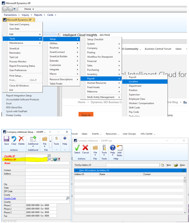

    ​A test environment with all databases having been "restored"; however one company is not showing the address ID data. The facility id data is present.  I have verified that the data is in the company table. Confirmed the alt/mod forms and reports.

    The screen you showed here doesn't look like the original GP screen.. This is the same shared from that is also accesible under the company Address card :  Administration >> Setup >> Company >> Company >> Address button
    The data is stored in the table SY00600 from the Company DB.
    The field "Facility ID" that you're showing in your screen shot seems to come from another product.. Maybe a 3rd-party module that replaces the original form in GP. You can that here : Administration >> Setup >> System >> Alternate/Modified Forms and Reports

    I can see you're using Multi Entity Management. Just speculating that it might be security-related issue.
    Have you checked the User Facility Setup window?
