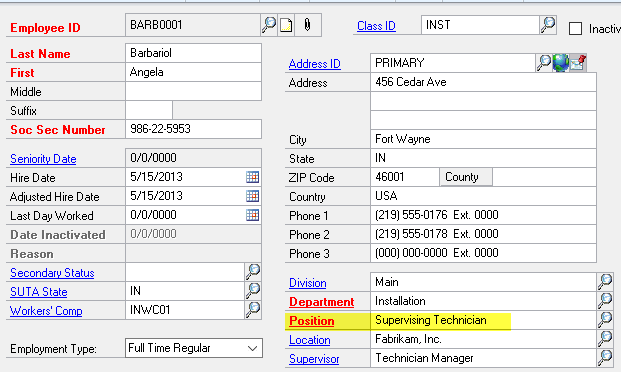

    That is odd.... that you're not getting any prompts.  Are you making the changes on the Employee Maintenance window?  If so, and the HR module is registered, you automatically receive these prompts when changing any of the Organizational codes and saving the window.  (Division, Location, Dept, Position and Supervisor.)
    For the benefit of those who aren't familiar with the great history the HR module can capture, I'm showing my testing below:

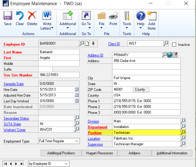

    1. Angela's current Position is "Technician", but, she has been promoted to "Supervising Technician".
    2. I selected the "Supervising Technician" for her new Position and Saved the window:

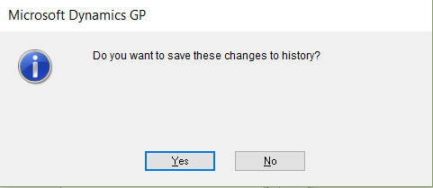

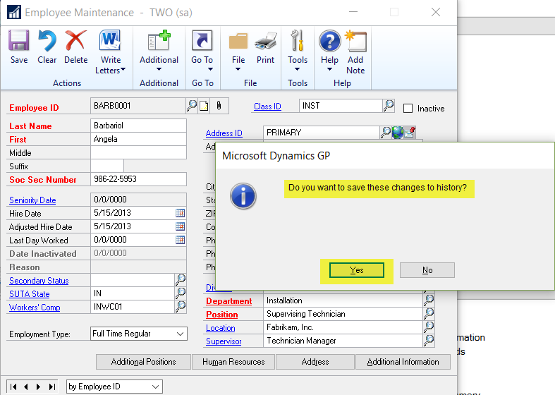

    3.  I received the following prompt and selected, "Yes":

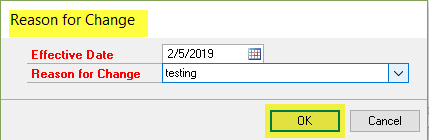

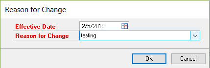

    4. I received the next prompt and entered the Effective Date and Reason:

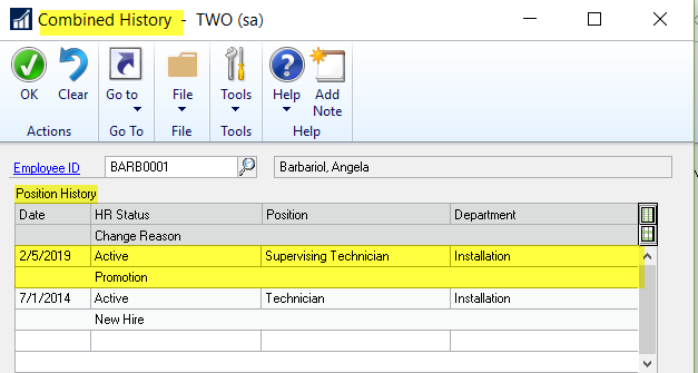

    5. The resulting Position History record was created:
    Perhaps you/your customer is using a different window to change the position? Or, using an Add-On product or customization?
