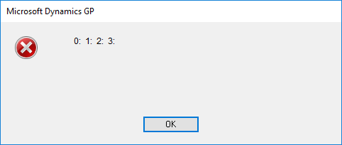

    This does not produce any results.
    GP Results Image

    I think the issue here is that the window is using a temporary table.
    Your VSTools code is using a new blank instance of the same temporary table ​.
    You need to get access to the actual instance of the table buffer used on the Dexterity form.
    Please note that this is something that GP Power Tools can do. It is a lot harder in VSTools.
