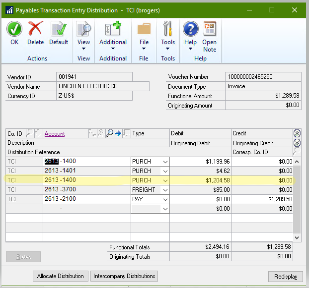

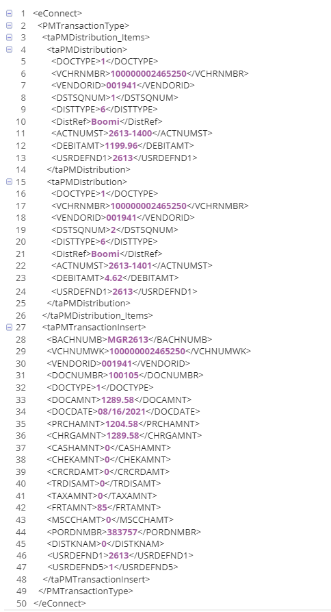

    I am using eConnect to load invoices from another application into GP with MEM.  I'm populating Distribution Line for the PURCH DistType and allowing GP to calculate the rest of the distribution for Freight and Discount.  What I'm seeing is that when GP does the calculation it adds my PURCH lines together and creates another one with the total amount to our 1400 line.  Can anyone provide some insight on why this would be happening?  It's like the calculation ignores the distribution lines I load.  Below is a screenshot of how the distribution looks in GP.  The yellow line is the additional 1400 that throws it OOB.  Also included is the XML I'm sending.  Any help would be greatly appreciated.  I'm learning eConnect on the fly and have made a lot of progress.  This issue has me stumped.

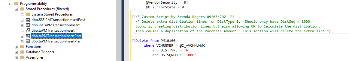

    In the taPMTransactionInsertPost procedure I added the following code snippet.  It finds any distribution lines with a DSTSQNUM > 1000 and a DISTTYPE of 6 (Purchases) and deletes it.  This code is added prior to any stock code in the procedure is run in order to allow MEM to work with only the corrected distribution.
    /* Custom Script by Brenda Rogers 09/03/2021 */
    /* Delete extra distribution lines for DistType 6. Should only have DistSeq < 1000.
    Boomi is creating distribution lines but also allowing GP to Calculate the distribution.
    This causes a duplication of the Purchase Amount. This section will delete the extra line.*/
    Delete from PM10100
    where VCHRNMBR = @I_vVCHNUMWK
    and DISTTYPE = '6'
    and DSTSQNUM > '1000'
    If anyone can find holes in my logic please do let me know.  I have tested it against several invoices and it seems to be working beautifully but more extensive testing is still needed.

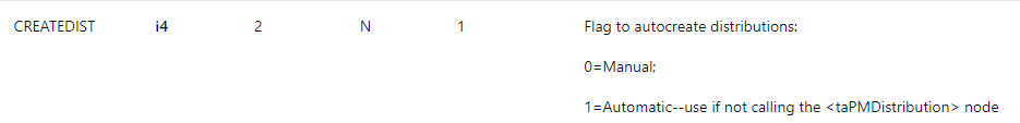

    I haven't worked with Boomi, so I'm not sure what complexity that might be adding, but I didn't see you passing a value for CREATEDIST in the XML.  The default is 1, which I think is going to ignore anything you pass on the taPMDistribution node.
    Here is a schema reference - despite the date on the documentation, it's the most up to date:
    https://docs.microsoft.com/en-us/previous-versions/dynamicsgp/developer/jj193390(v=msdn.10)
