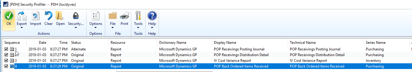

    ** This last useful way of profiling just popped in my mind as I was writing the answer, so I gave it a shot for you, and here is the result :
    Security profiler while receiving
    As you can see, the resource is named "IV Cost Variance Report" and is under the Inventory module.

    Not at all, mon ami! I had used GPPT to look for that report... but I just didn't look under IV. I also neglected to look at Reports in the Security Log for our Office Manager. Once I checked that box and saw the reports she'd been denied access to, I simply checked the box for that report and changed her Security profile... et voilà!
    Thank you for helping me get back on the rails.
