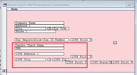

    I opened the report in GP Report Writer and there is only 1 field left for the street address.
    I don't think MEM will change anything in that case..
