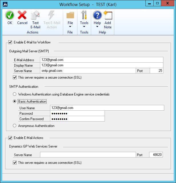

    Hi,
    We've been looking into implementing workflow at our company and therefore started looking into all the features it has to offer. Right now the email test is not working for some reason. We send out remittances and order confirmations without any problem so not sure what's preventing this feature from working. Any help would be greatly appreciated
    test
    Karl Solski
    MIP Inc.
    Anjou QC

    Karl, you need to have a Web Services server running to utilize Workflow, and there's none listed in your screenshot.
    Charles Ray
    Senior Systems Specialist
    CAL Business Solutions, Inc.
    Harwinton CT

    Your gmail settings look to be off a bit, maybe take a look at them.
    Here is some basic settings.  You can get gmails info on non-authenticated accounts as well.
    Allen Schierholz
    System Administrator
    Forum Communications Company
    Fargo ND

    If the Test Emails aren't working then more times than not your SMTP information in the Workflow Setup window is not correct.
    Web Services actually is not needed at all to use Workflow, unless you want users to have the ability to take action (approve, reject, delegate) workflows through the email notifications sent to approvers.
    I think Michael is on the right track as I question port 25 but haven't done a lot of setup using GMAIL accounts or SMTP credentials.
    I know as a test, we often have users setup a new outlook.com email address, then use that along with the following SMTP information to test, which will often work:
    -- E-Mail Address: User@outlook.com
    -- Display Name: User Name
    -- smtp-mail.outlook.com
    -- Port: 587
    -- Mark the option of 'This server requires a secure connection (SSL).'
    This would at least help verify that it is the GMAIL information being entered for the SMTP setup.
    You can also run the 'EXEC wfDeployClrAssemblies' script against your DYNAMICS/system database which will drop and re-create the objects that Workflow uses, including the procedures used for the test and actual workflow emails.

    First of all thank you so much for all the help and suggestions.
    Regarding my screenshot I forgot to uncheck the "Enable Email Actions". I was trying different things and left it in there by accident. Right now the Email Test isn't working so I haven't even bothered looking into the Email actions. We currently don't have web services installed but from what I understand these aren't required for simple email notifications.
    I've tried all the suggestions but still haven't managed to make it work. So I'm pretty much at the stage where I will try the EWSEditor tool and go from there.
