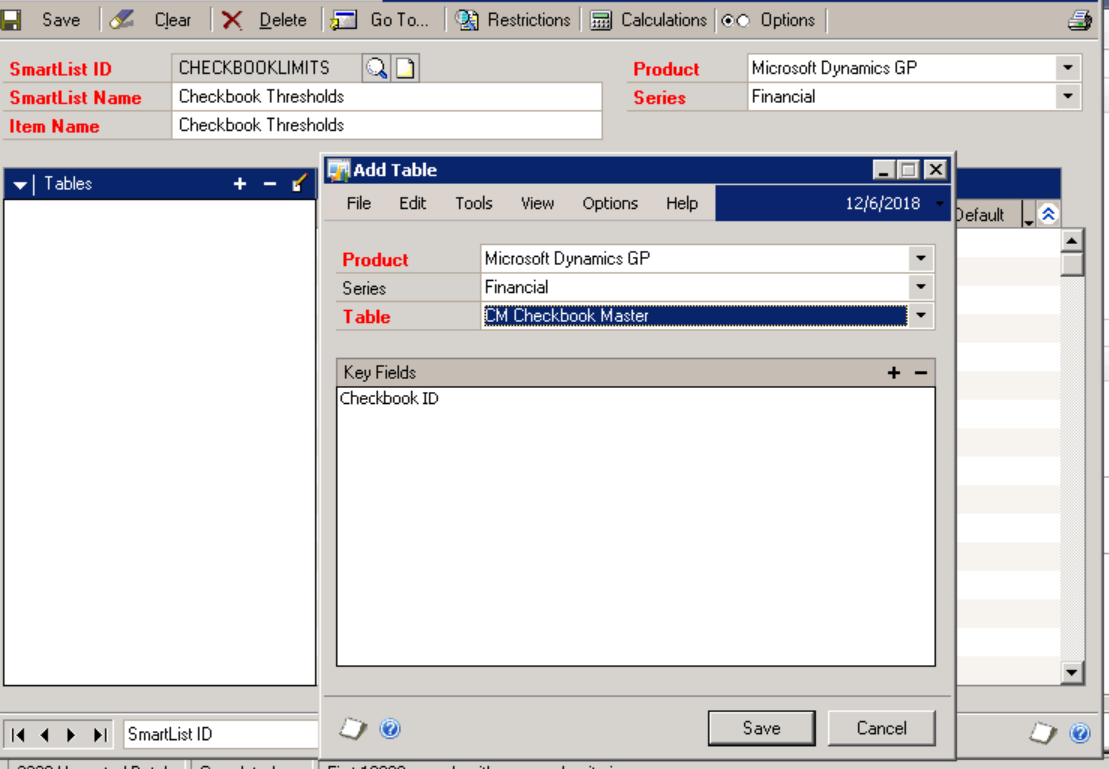

    Simply put, here's the basic script.
    SELECT       RTRIM(CHEKBKID) [Checkbook ID],
                        CAST(MXCHDLR AS decimal (12, 2)) [Maximum Check Amount]
    FROM         CM00100
    ORDER BY [Checkbook ID]

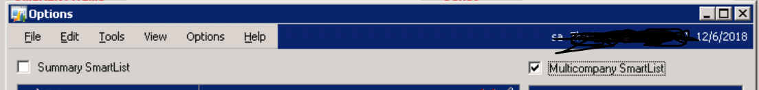

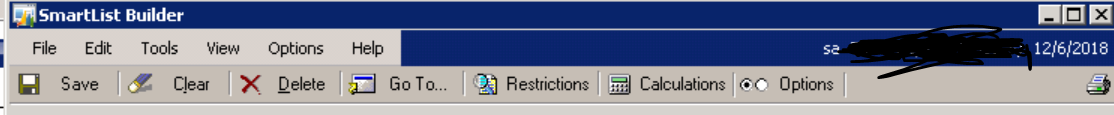

    If you have SmartList Builder, create your SmartList
    Step 1
    Click Options
    Under Multicompany SmartList, check all of the companies you want to appear.
    Step 3
    Add the object under security and VOILA!  Hope this helps.
