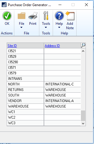

    Now along came PO Generator. The creative developers added a x-reference table POP40800 to associate each SiteID with the CompanyAddresses Setups.
    When the PO is generated, they populated the Line address data with the CompanyAddress data not the SiteAddress data and filled in the CMPANYID field from the CompanyAddress associated in POP40800 with the SiteID. In the PO Generator Suggested Preview, the Ship To Address is a Company Address ID that popped in there based on the table and the SiteID for the item

    Oh and if you have not completed the POP40800 X-Reference table for Company Address to Site IDs, then the PO generator will default to the Primary Display Company Address data as the Ship To.
    Here is the cross reference to associate SiteIDs (warehouses) with Company Addresses:
