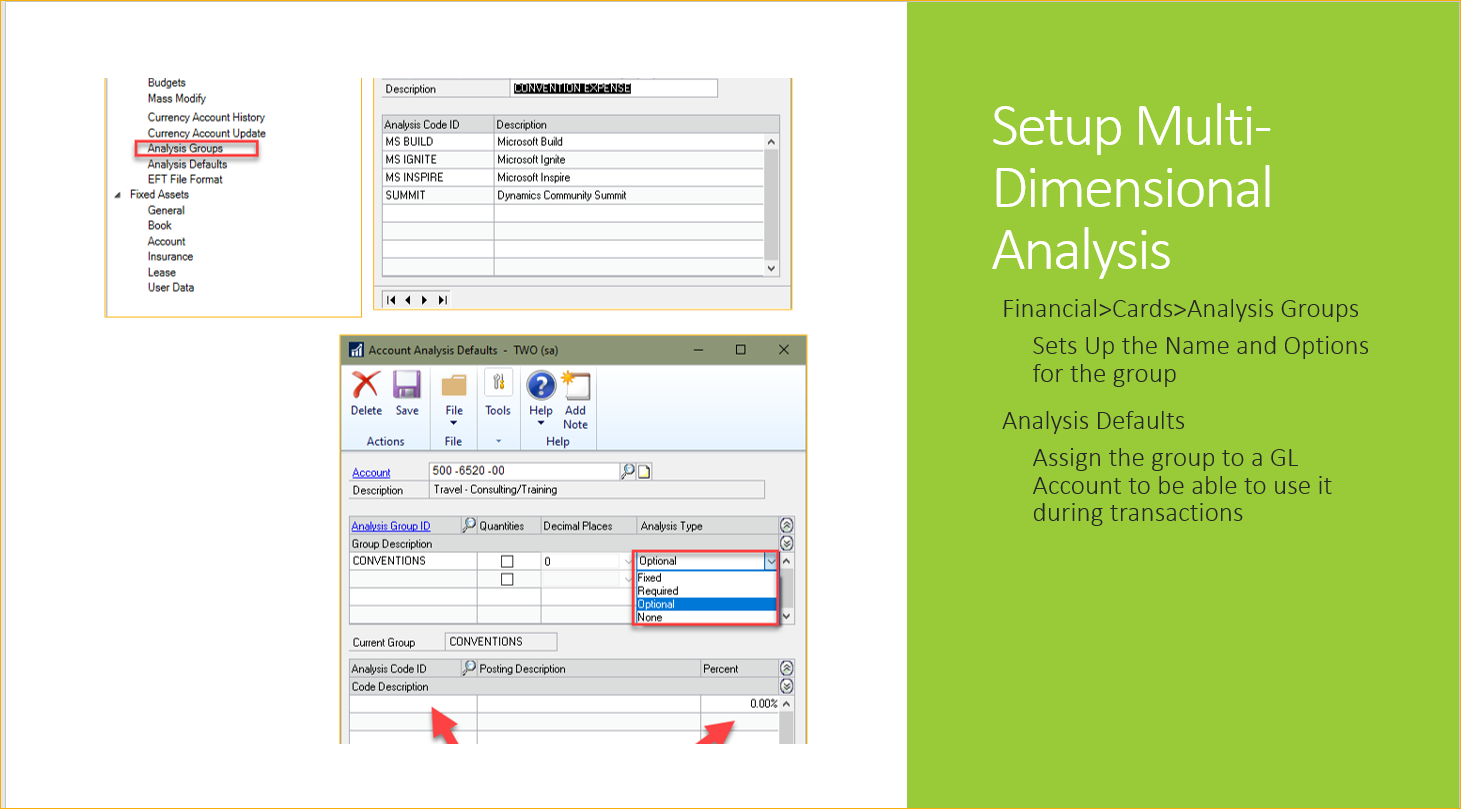

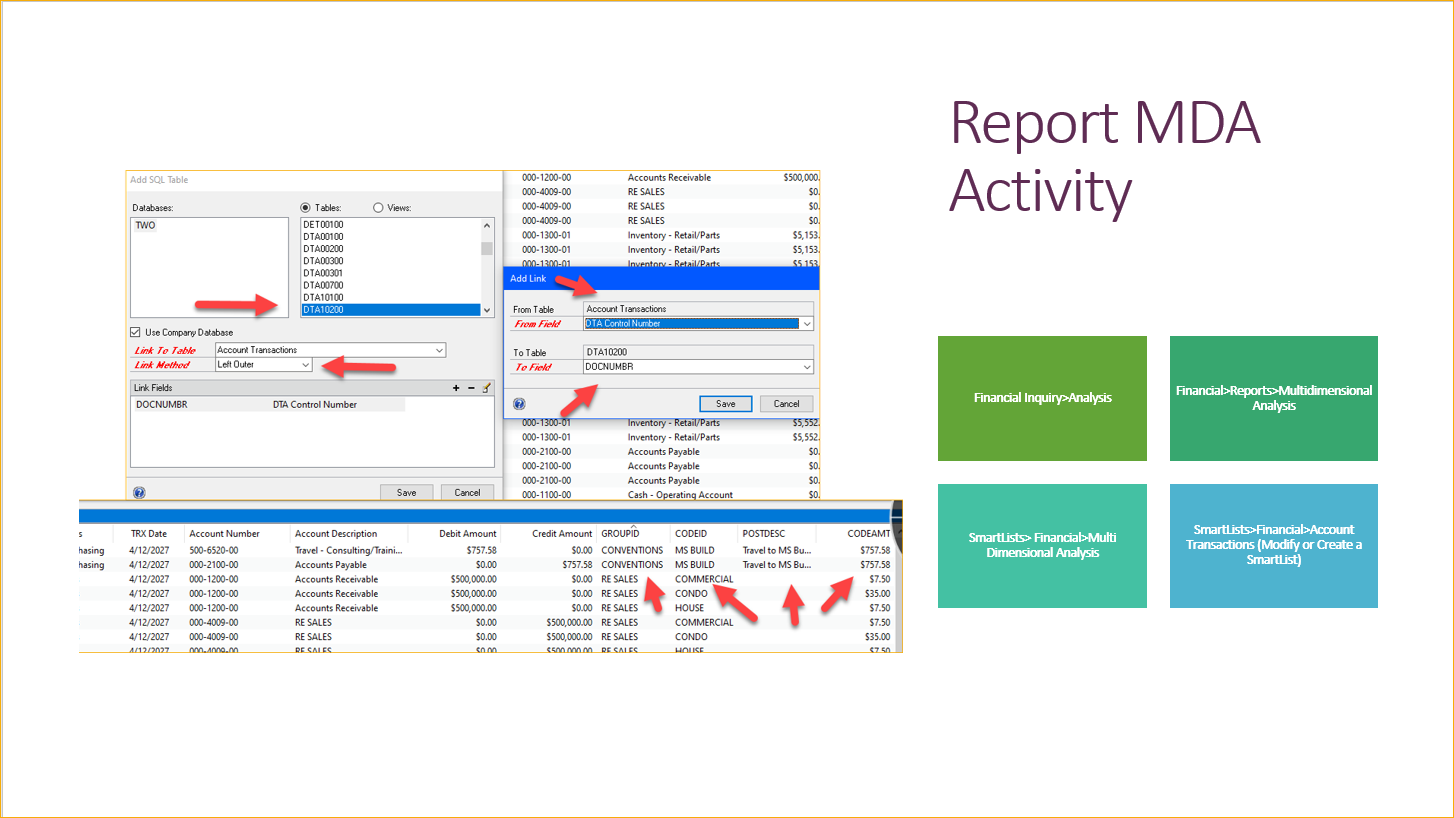

    As an alternative, GP also comes with a product called MDA (you already own it, in other words).
    Using MDA can give you the reporting you are looking for as well, but it is not as cumbersome as AA.
    I had presented on this topic in The Little Known Modules presentation the last summit, but here is a bit on MDA (in my opinion a great alternative)
    Here is a link back to an article comparing MDA with AA in GP
    https://support.microsoft.com/en-us/topic/comparison-of-the-features-of-analytical-accounting-and-of-multidimensional-analysis-in-microsoft-dynamics-gp-834506b8-15be-3a57-f1c3-e40c0c838b41
