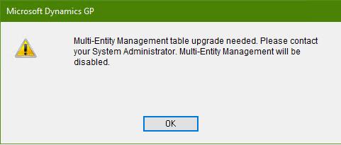

    I am working in our test environment and did a db restore from a previous backup done in June.  The restore seems to work fine but when I log into GP I get the message below saying I need to upgrade a MEM Table.  Has anyone seen this message and know how to troubleshoot.  This is a copy of our Production Environment and we have not made any changes to either environment recently.
    I have compared the table data between the following tables and they match for both environments

    If your Test Environment is a separate instance with its own DYNAMICS database take a peek in the DU000020 and compare the product ID versions, major, minor, build versions  to your production Dynamics same table for the product. The DU000010 will have the specific tables under fileOSName and you can compare at the table level also.
    It may be that your Test environment Dynamics is not current with the Test environment Company database(s) you restored from production.
