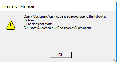

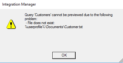

    Hi Cynthia,
    Unfortunately IM doesn't like variables in the source data path/name..  neither %userprofile% (which would hold the drive letter and full path) or %userName% (which is the Windows user name alone) are accepted..
