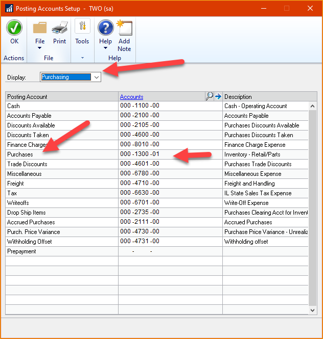

    You can set the account in Tools > Setup > Posting > Posting Accounts > Purchasing > Purchases. This account will be defaulted any time you enter an item that doesn't have a purchasing account (e.g. non-inventoried items)

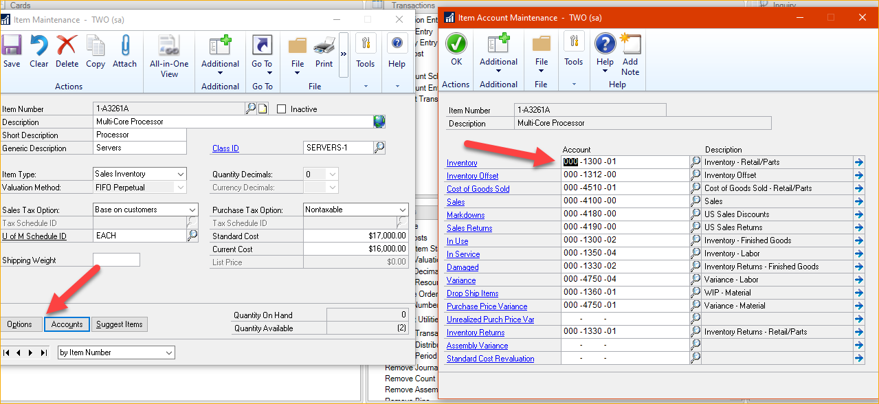

    The GL Account number is determined at the item level (IF you've setup the item as an Inventory Item in GP).  Bear in mind you can setup items as Miscellaneous if you do not actually count the stock as in 'non-inventory'.
    Otherwise, you can simply key in an 'item' and if it does NOT exist as a pre-setup item in GP's inventory module then the GL Account number comes from here:
    Which is why if you want to control what division/department, etc an item is for it is best to create an item and then multiple sites in GP.  Site setups in inventory can choose to override a segment of the GL based on what site you decide to order from or sell from (sites are in cards in inventory):
    This way you can have one item, but use the site setup to control the full GL Posting account.
