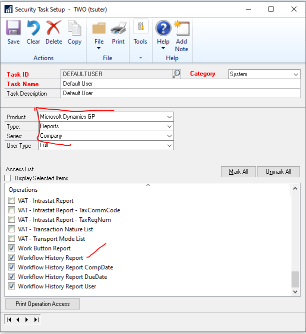

    What security task do I give the user so that they can run the Workflow History report?

    Hi Lori,
    In my GP 2018, the task is RPT_COMPANY_013* and the role that uses it is ACCOUNTING MANAGER* . There could be others, if you have added other tasks and roles.

    Lori! How are  you?
    We add these to the DEFAULT User Task normally but you can add them to any Task if you want them access more restricted. Or make a new Task: RPT_WF_01

    Thanks! I'm all set now Thad. You are still working? Hope you are well.
