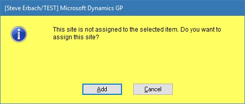

    Dear Collaborators,
    We're going through a bit of pain here at the beginning of the new year and I hope that you folks can provide some pain killer!
    When entering line items on a new Sales Order, if the user enters a Site ID for an Item that hasn't been assigned to that particular Item, this message appears:
    Is there a way in GP to disallow the assigning of the Site to an Item? In other words, Is assigning site IDs on-the-fly like this controllable in the Security profile for a user?

    I doubt this can be turned off since assignation is mandatory.  Thus, if you click on "Cancel", notice that it does Cancel the move to the next field and return on the item number.  If you try again to tab out, it will popup again.
    So, if the item is not assigned, GP will either ask you to assign it, or to cancel and blank or change your item number, but continuing without assigning is not an option.
    For this, I may be wrong, but turning off the popup should not be possible since it would allow, in a certain way, to continue to next field without assigning...
    ** Edit -> I just thought of something else...  If what you meant is that you would like to popup just a window saying "Site is not assigned to this item" with only an "OK" button, this is something very easy to code in .Net addins.
