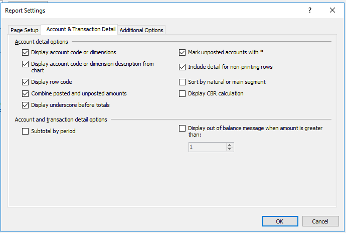

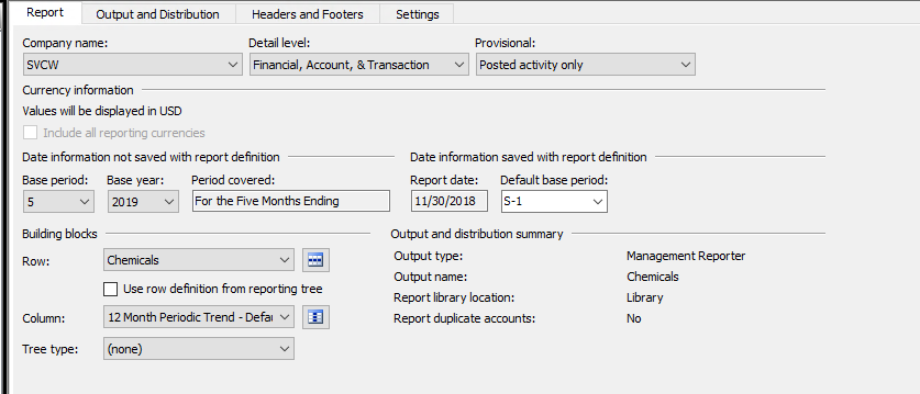

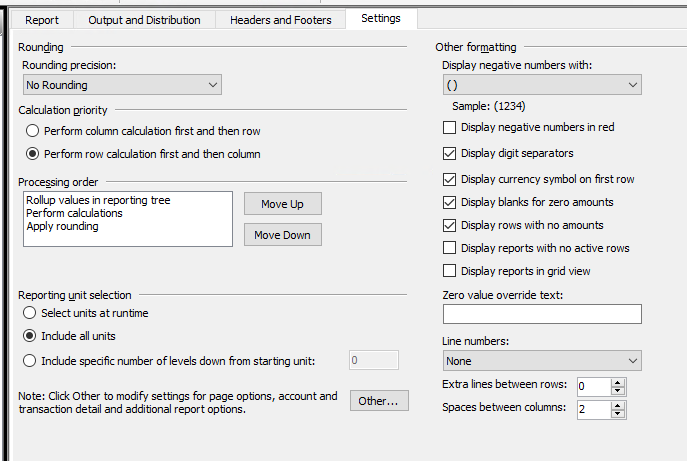

    I built a report using Management Reporter, and then someone went in and clicked a bunch of buttons, now my report will not drill down to transaction level detail.  It says Summary, Account, and Transactions but it wont do it?? I have tried recreating the report and it wont work at all anymore?
    Here are my settings
    These are my settings

    The first thing I noticed was that the Base Period and Base Year are in fiscal year 2019. Is your fiscal year from July to June?
    Do you generate the reports into the web viewer or the MR client viewer? You might try the client viewer (in MR Designer, Tools >> Options >> Use Management Reporter Report Viewer as default viewer).
    ​As a systematic kind of guy, I would have built the report from scratch, too. If that didn't work, as in your case, I would try running the original report with a reduced detail level like Financial & Account. If that doesn't work, then I'd start to wonder about rebuilding the datamart.

    I'm pulling from memory but I'm pretty sure you can only get transaction-level detail if columns are periodic (versus YTD). If you want a YTD column with the ability to drill down to detail level, you'd have to create a periodic column and then put 1:Base in the period section.
    Let me know if this doesnt make sense. Also, maybe a screenshot of the column definition of the report in question would help.

    Kyle Malone is correct. YTD columns only will not pull transactions. We would need to see the column definition to know for sure.
    Another quick check, export the report to Excel with Financial, Account and Transaction details to see if there are any transactions exported to a -T worksheet tab.
