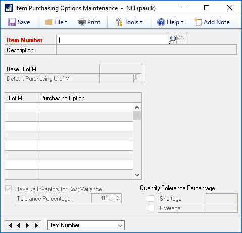

    Your standard cost should be based on on how you stock and consume the inventory, the base unit of measure, in this case LB UoM. Great Plains allows you to have multiple purchase units of measure, For example, today you buy in 5LB Bag size. Tomorrow, you may buy in a 10lb  package size or 100LB Crate for price advantage.
    However, you are consuming always at the LB UoM. Where your purchase UoM is different that your base UoM, you do need to set-up the purchase UoM in the Item Purchasing Options Maintenance Card for on the Inventory > Cards.  Native GP will automatically convert inventory at receipt to the base UoM and handle the cost conversion properly as well.  There is not need for a separate conversion utility.

  • 7.  RE: Standard Cost on Inventoried Items
    Posted Mar 15, 2019 10:07 AM
    I forgot the Purch U of M. Here it is. Not necessarily = the Base UofM
