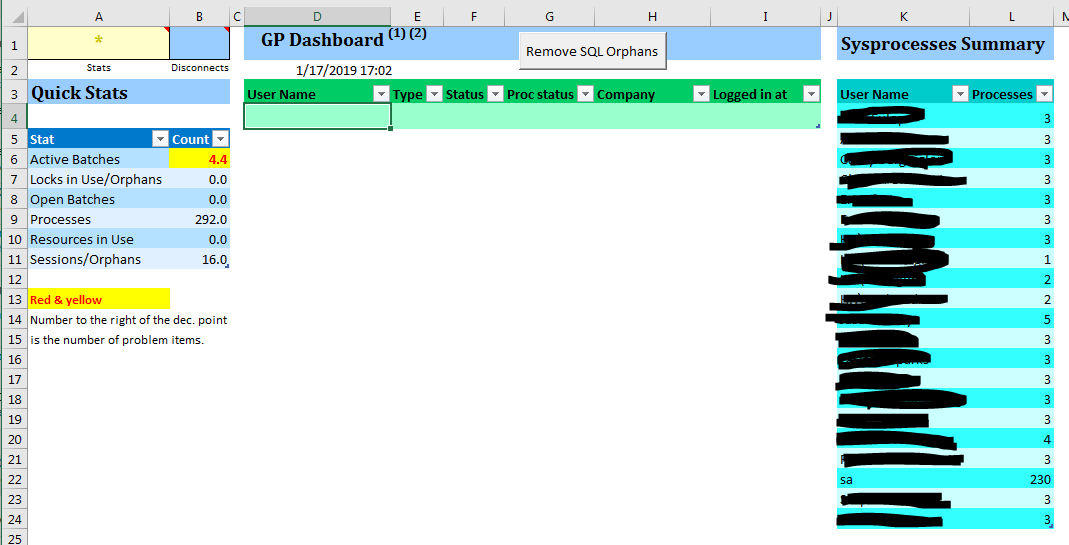

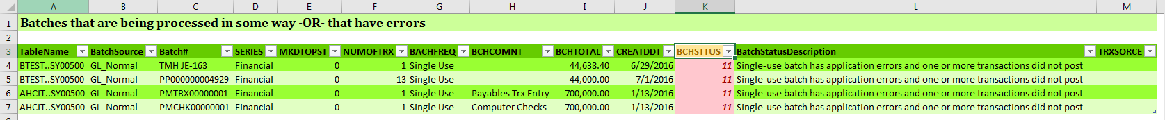

    I finally had a little time to try this out. And I was successful (mostly)! It was my first experience with a refex.
    Unfortunately, I am on SQL Server 2008. So I am getting errors on the FORMAT function. I modified the ones I found in the stored procedures but I am still getting errors.
    But I am still getting some data:
    Dashboard screen shot
    I even see some errors - these are test companies though:
    Active Batches screen shot
    Thanks for the webinar and making this available!
    Sandy Righi

    @Sandy Righi,
    Thank you so much for jumping in with your experiences!
    Let's see... first: the ​list of Active Batches showing errors (BCHSTTUS = 11) means that those batches will likely have to go through Batch Recovery. I've seen plenty of times where the user isn't even aware that a batch had problems. So everything's normal there.
    What version of GP are you running?
    During development of the GP Admin Dashboard, I only had access to SQL Server 2012, 2014, and 2016... couldn't test on older versions of SQL Server. Sorry about that! FORMAT has changed over the versions, for sure.
    >> but I am still getting errors <<
    Do tell! Don't keep us in suspense! I might be able to help.
    I see that GP is reporting 16 sessions, but you're not seeing any User Names. We've seen issues with the fact that I've only had GP 2016 to report on. I know that different versions have had changes to table structures... and you might be seeing such an issue with your User List and your Session list... but there's no way for me to test. Looks like you're a guinea pig!
    Send your error messages to my Gmail address (serbach) and I'll help you work things out.

    It occurred to me that there might be an issue with the udfDatediffToWords scalar function. My cohort, @Beat Bucher, reported​ an issue with that function in some of our early testing. It's certainly a non-essential function. It's only purpose is to format the length of time someone's been logged in into days, hours, and minutes instead of just minutes.

    Success! I have a working dashboard!
    After following Steve's suggestion to edit and test the SQL connections in the refex, I modified the code where needed to remove the "FORMAT" function and I have data.
    Thank you again to Steve and Beat for sharing!
