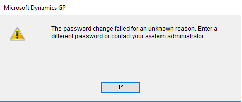

    Over the last few weeks we have noticed an issue when a user tries to change their password using User Preferences.  They can make change on the window, click OK, and the window closes.  Then an error message pops up:
    Afterward another window opens stating to use the old password upon login.

    10. Received this message
    11. After clicking OK, received another message telling her to use the old password.
    Difference between now and in the past....the error messages appear at logout.  Before they appeared while attempting to save Password change.
